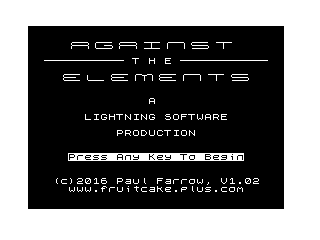

The game runs on a standard 16K ZX81 and is in the isometric style made famous on the Spectrum by Ultimate. It uses the pseudo high resolution techniques pioneered by companies such as Macronics and Software Farm.

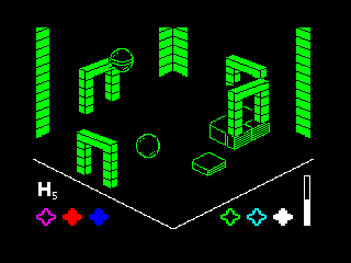

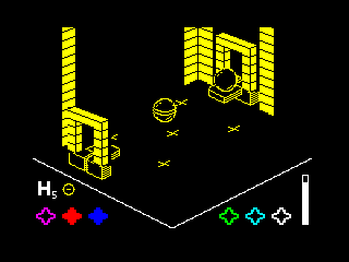

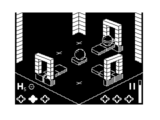

The bottom side areas of the screen are used to display status information. The large H followed by a subscript number shows how many lives are remaining. Next to this will appear a circle with a minus sign in it whenever you have picked up an additional electron. The six '+' shapes running along the bottom show which parts of the antidote have been collected. Parts that have been found are shown filled in. The vertical bar on the right indicates how much time you have left. To the side of it will appear two large dashes whenever the game is paused.
The game is controlled using the cursor keys 5, 6, 7, 8 and 0 for jump, or keys Q, A, O, P and M for jump. Key 9 is used to pick-up/drop and SPACE for pause/continue. If the game is loaded on a system with a ZXpand connected then keys Q, A, O, P, M are replaced with support for the ZXpand joystick socket.
You must be standing on an electron in order to pick it up. You cannot jump into an archway or jump while in an archway. You also can't push an object through an archway. You can't die from falling but you will be killed if you come into contact with an infected atom, which are distinguished by having two stripes around their middle. When you find a Noble Gas you must push into it to collect its contribution to the antidote. At the end of the game, press the SPACE key to restart. Everything else you must work out for yourself!
The game includes full colour support for the Chroma SCART interface. The colour facilities should be switched on prior to loading the game.

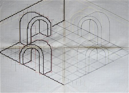

I had originally thought about creating an isometric game for the standard 16K ZX81 using the pseudo high resolution technique, similar in style to the Spectrum games created by Ultimate, back circa 1986. I wondered whether the limited pixel patterns offered by the technique would be capable of such a visually complex game. So I created a mock up on graph paper to find out whether it could. The results were encouraging, as the photo of the original mock up shows.

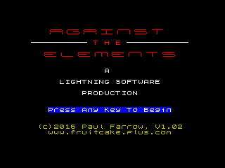

The title screen features a technique to display a near pixel perfect mix of uppercase and lowercase lettering. This technique was first used in Against The Elements, but a description of how the technique works can be found on the page for the program Celebration.
