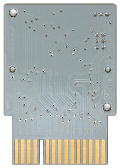

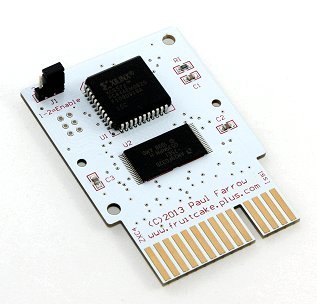

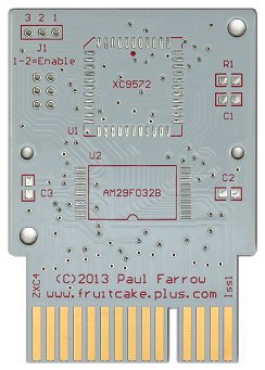

The PCB can be seen below:
A populated ZXC4 PCB and the case I produced for the ROM cartridge can be seen below.

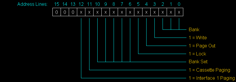

The lower control region is selected by accessing an address with the Write and Page Out bits both set to 1 and the Lock bit reset, e.g. $3FD8. The states of the other control bits are ignored. The ZXC4 will subsequently intercept accesses to the lower 8192 ROM locations ($0000-$1FFF), interpreting them as follows:
| Bank | Selects between the 8 banks available within the active bank set. | |
| Write | Set to 1 to assert the /WR line to the FLASH ROM. Set 0 to return to read mode. | |
| Page Out | Set to 1 to page out the ROM cartridge, thereby allowing access to the Spectrum ROM (or Interface 1 ROM if paged in). Set to 0 to page the ROM cartridge back in. | |
| Lock | Set to 1 to prevent further paging. This can therefore be used to permanently make a bank of the ROM cartridge visible to the Spectrum, or to permanently page out the ROM cartridge. | |
| Bank Set | Selects between the 32 bank sets available. | |
| Cassette Paging | Set to 1 to enable interception of the LOAD and SAVE routines within the Spectrum ROM. At the end of the first byte of an instruction fetch from address $04C2 (SAVE_BYTES) or $0556 (LOAD-BYTES), the ZXC4 switches to bank 3 within the current bank set. If the instruction at $04C2 or $0556 is a multi-byte instruction (which it may be if the Spectrum ROM is active) then it is necessary to replicate the instruction within bank 3 so that the remaining instruction bytes are still available after paging in the ROM cartridge. The ROM cartridge pages out at the end of the first byte of an instruction fetch from address $04C2, $0556 or $0555. Addresses $04C2 and $0556 allow the ROM cartridge to return control to the Spectrum SAVE and LOAD ROM routines respectively, and address $0555 allows a single byte RET instruction to return control to the routine that called LOAD or SAVE originally. The ROM cartridge pages out after reading the RET instruction but prior to executing it and hence the return will occur within the Spectrum ROM. Note that the Cassette Paging mechanism overrides the ZXC4 Lock function. This means the ZXC4 can be paged out and locked, thereby allowing full access to the Spectrum ROM. When an access to location $04C2 or $0556 occurs, the ZXC4 pages in bank 3 of the currently selected bank set. It is important that the ZXC4 was previously locked with the upper control area active because $04C2 and $0556 lie within the range of the lower control area. Once the ROM cartridge has been paged in via the Cassette paging mechanism, it becomes possible to reset the Lock bit and thus gain access to the other banks of the 4MB ROM. To return to the Spectrum ROM, the Lock bit and bank 3 should be re-selected before paging out the ROM cartridge by executing an instruction at $0555, $0556 or $04C2. | |
| Interface 1 Paging | Set to 1 to enable the ZX Interface 1 compatible paging mechanism. At the end of the first byte of an instruction fetch from address $0008 (the error handler routine) or $1708 (the CLOSE command handler routine), the ZXC4 switches to bank 2 within the current bank set. If the instruction at $0008 or $1708 is a multi-byte instruction (which it may be if the Spectrum ROM is active) then it is necessary to replicate the instruction within bank 2 so that the remaining instruction bytes are still available after paging in the ROM cartridge. The ROM cartridge pages out at the end of the first byte of an instruction fetch from address $0700, and a RET instruction is typically placed here and jumped to to make a return to the original calling routine within the Spectrum ROM. The ROM cartridge pages out after reading the RET instruction but prior to executing it and hence the return will occur within the Spectrum ROM. Note that the Interface 1 Paging mechanism overrides the ZXC4 Lock function. This means the ZXC4 can be paged out and locked, thereby allowing full access to the Spectrum ROM. When an error occurs or a CLOSE command is executed, the ZXC4 pages in bank 2 of the currently selected bank set. It is important that the ZXC4 was previously locked with the upper control area active because $0008 and $1708 lie within the range of the lower control area. Once the ROM cartridge has been paged in via the Interface 1 paging mechanism, it becomes possible to reset the Lock bit and thus gain access to the other banks of the 4MB ROM. To return to the Spectrum ROM, the Lock bit and bank 2 should be re-selected before paging out the ROM cartridge by executing an instruction at $0700. For further details on the ZX Interface 1 paging mechanism, refer to the ZX Interface 1 ROM disassembly. |

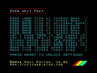

I've created a program to allow a ZXC4 ROM cartridge to be tested. When the Spectrum is powered on, the test program will automatically run and will execute a sequence of tests. At the end of the test sequence, the ZXC4 locks its paging mechanism. Resetting the Spectrum (using a reset button) should cause the ZXC4 to unlock its paging mechanism and so allow the tests to run again. If the tests run successfully for two consecutive passes then the ZXC4 is working correctly.
NOTE: Running the tests will erase the contents of the ROM, including the Flash Programmer if present. The Flash Programmer will need to be re-instated from a backup afterwards before the cartridge can be re-programmed, so make sure you have a means available to restore it (ZX Interface 1 RS232 or Cassette). The test utility should only be used if you suspect there is a problem with the ZXC4.
| Click here to download the ZXC4 Unit Test. |
