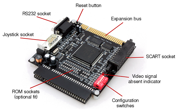

The SPECTRA interface measures 10cm by 10cm. The key items of the interface are shown labelled in the following photograph:

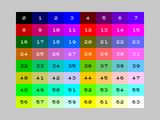

The 64 colour palette available with the new display modes is shown below. Six bits are used to define each colour, with 2 bits used per red, green and blue component.

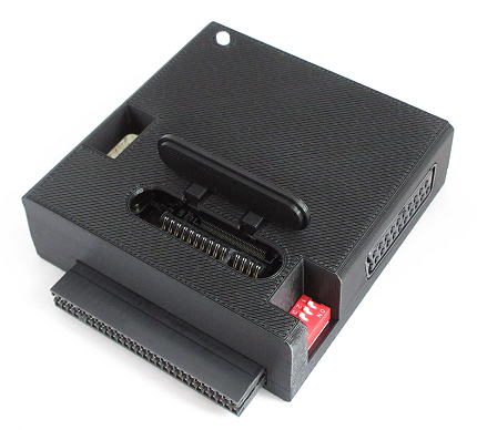

A plastic case is available for the SPECTRA and SPECTRA+128 interfaces, as shown in the following photograph:

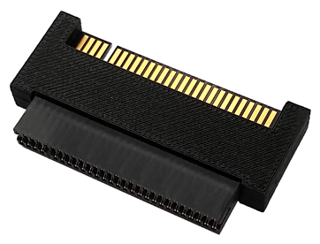

The SPECTRA+128 interface can be used with the Spectrum+2A and Spectrum+3 via the SPECTRA+3 Adapter board, which also has a case available for it, as shown in the following photographs:
