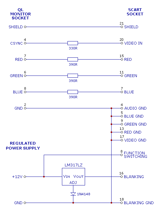

The Sinclair QL also provides a female 8 pin DIN for its monitor socket although the signals output by each pin are slightly different to the Spectrum 128. The pin-out configuration is shown below.
Sinclair QL RGB colour outputs require additional resistors, as does the composite sync signal. The circuitry required is shown below.
