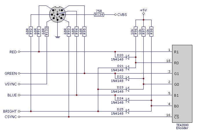

The ULA in the Spectrum 128 outputs TTL level red, green, blue and sync signals and from these a TEA2000 Encoder video chip
produces a composite video signal. The TTL level signals are taken to the monitor socket via 68 ohm resistors and the composite video signal
is taken to the monitor socket via a 75 ohm resistor, as shown in the diagram below.
