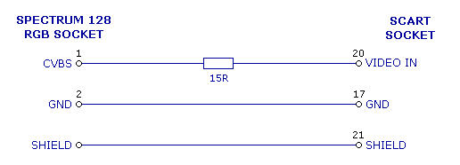

The simplest way to connect the Spectrum 128 to a SCART socket is to use the composite video (CVBS). This requires only the connections shown below. A 15 ohm resistor may be placed inline with the CVBS signal to reduce the 1.2V signal out from the Spectrum 128 down to the 1V level required by the SCART socket. For best results use screened cable and attach this to the connector shields at both ends, but make the connection prior to powering on the TV or Spectrum 128.
Although the picture quality from the CVBS signal is significantly better than from the standard RF connection, it will usually suffer from colour fringing. To achieve the best picture quality requires connecting the Spectrum 128 to a SCART socket using RGB. However, this is more involved as it requires the three separate colour signals and a synchronisation signal.

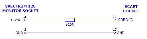

The synchronisation signal may be obtained using the CSYNC line or the CVBS line. When using the CVBS line, it should be connected as shown above. Note that even though an RGB connection only requires synchronisation information to be delivered to SCART socket's VIDEO IN line, the CVBS signal can be used because a TV will generally ignore the picture information and just extract the synchronisation information required. It also has the advantage that the cable can be used in RGB or Composite Video mode. When using the CSYNC line, its voltage must be reduced using a resistor as shown below, and this results in a peak current of approximately 4mA.

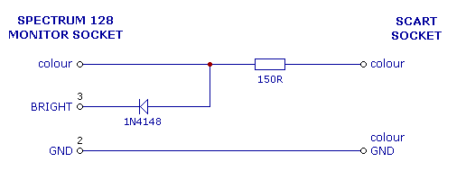

Each colour line must be reduced to a suitable level for the SCART socket and mixed with the BRIGHT signal to yield both colour shades. The circuitry required is shown below.
The 150 ohm resistor reduces the colour signal down to the maximum level suitable for the SCART socket, and yields a peak current of 9.3mA. The current may be reduced by increasing the value of the resistor. This will darken the TV picture but may be compensated for by adjusting the brightness controls of the TV. The circuit operates as follows. When the BRIGHT signal is high, it has no effect on the colour signal level due to the diode and hence the bright shade of the colour is produced. For the normal intensity colour, the BRIGHT signal is low and the diode conducts thereby pulling down the signal level coming out of the Spectrum 128.

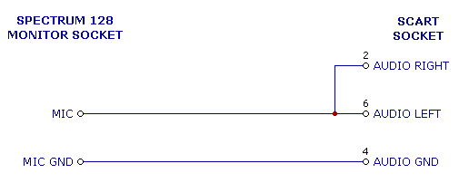

A drawback of the Spectrum 128 monitor socket is that, unlike the Spectrum +2A and +3, it does not provide a sound output. It is therefore necessary to obtain the sound signal from the MIC cassette port via a 3.5mm Jack plug. The SCART socket has separate connections for left and right audio channels and so these must be wired together. The voltage from the Spectrum 128 MIC socket is typically 200mV and this is directly suitable for driving the SCART socket's audio inputs. The SCART socket's audio ground should be connected to the outer contact of the Jack plug. Although this runs the risk of creating a ground loop, it avoids the far bigger risk of connecting the Spectrum 128 to the TV SCART socket via only the MIC socket, which means there would be no 0V reference line between the Spectrum and the TV and if they happened to be at different potentials then a far higher current could unintentionally flow and cause damage. The wiring of the audio signals is shown below.

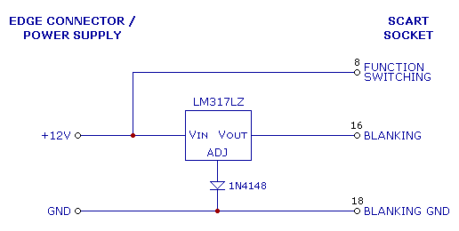

Using a voltage regulator can overcome the loading issue on the power line. Since the RS232 and KEYPAD sockets deliver their +12V line through a 180 ohm resistor, it is not ideal to use these as the input to the voltage regulator. So instead +12V could be taken from the expansion bus. The circuit below will generate 1.67V and so is suitable for driving the BLANKING input. The voltage may be increased to 2.1V by adding a second diode in series with the first. However, a SCART cable that must also plug into the expansion bus results in an inelegant solution, and so a neater approach is to simply to use an external source of power. This could be from batteries but it is preferable to use a regulated mains adapter.

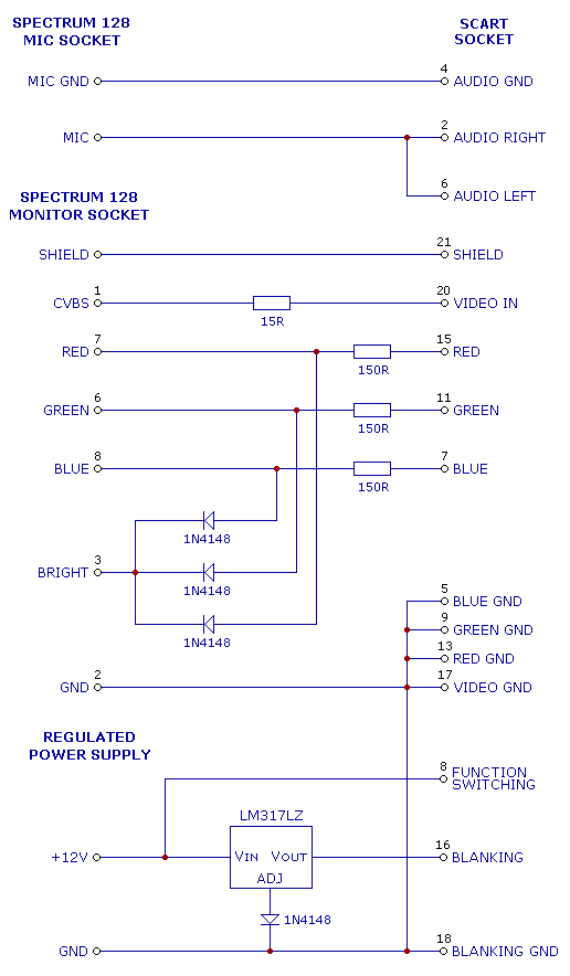

Putting all of the above theory together, the complete wiring of a RGB SCART cable suitable for the Spectrum 128 is shown below. For best results, use screened cable and attach this to the connector shields at both ends. Note that the design uses the CVBS signal such that the cable can also provide a Composite Video connection when an external +12V power supply is not attached. This could be replaced with the CSYNC line circuitry previous described if preferred.
