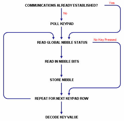

The keys on the keypad are arranged as a 5 row by 4 column matrix, with two keys on the bottom row not being implemented. Once a successful poll has occurred, the FLAGS nibble of 5B88h will be set to Ch and then each row of the keypad is read in. On subsequent reads of the keypad the poll is skipped if the FLAGS nibble (5B88h) already contains Ch and hence the rows are read in directly. It is therefore the two upper bits of the FLAGS nibble (5B88h) that indicate if communications to the keypad has already been established.
The rows are read in the following order: row 5, 4, 1, 2 and finally 3. Each row's data consists of four bits (one nibble) with each bit indicating the status of one of the keys in that row. Note that row 1 refers to the top row of the keypad. To avoid wasting time reading in rows where no keys have been pressed, a status bit is generated by the keypad and this indicates if any keys in the current row have been pressed. This status bit will be set (i.e. a value of 1) if any keys in the row are being pressed. The status bit is transmitted prior to each row, and only if this status bit is set (i.e. at least one key in the row has been pressed) will the row's nibble of data be transmitted. The Spectrum 128 will read in the status bit for the row and will therefore know whether to expect a nibble of data or to assume a nibble of 0h. If a nibble of data is transmitted then the bit corresponding to the right hand column of the keypad is transmitted first; this is referred to as column 4 in the rest of this text. A bit will be set to logic 1 if the corresponding key is being pressed. As each bit is read in, it is shifted into the most significant bit (msb) of the A register; previous bits read in to the accumulator are all shifted right.

Click here to view a graphical illustration of how the keypad rows are read and then decoded. |
