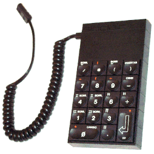

The keypad is similar in appearance to the Spectrum 128 casing with the same style of keys. Its measures 82mm by 150mm by 18mm deep, it has the same distinctive embossed parallel lines across it with the raised Sinclair logo in the top left hand corner and has four tiny circular rubber feet on its base.

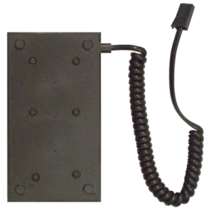

The keypad connects to the Spectrum 128 via a 350mm long coiled cable emanating from the top left hand edge of its casing. The cable begins with a 100mm flat section followed by 220mm of coiled cable of diameter 13mm and ends with 30mm of flat cable at the plug. The case is held together by six screws. The top two screws are 10mm in length and the other four are 8mm in length. The screw positions are inset by 1mm.

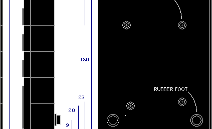

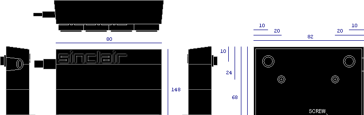

The keypad layout and dimensions in millimetres are shown below.
Click here to see the keypad diagram with legends in
