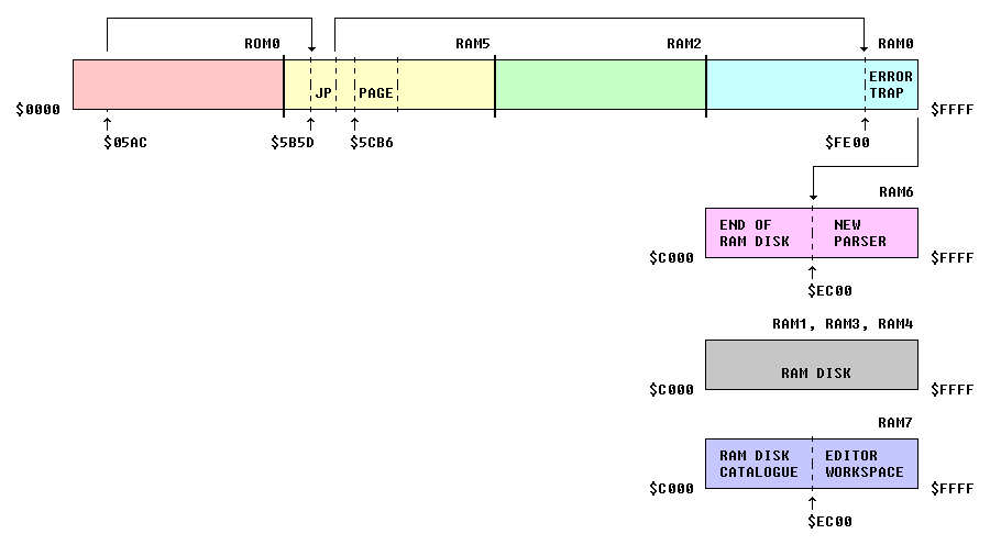

The Extended BASIC Framework attempts to support all versions of the Spectrum 128 and Spectrum +2 by locating the address of the ROM routines the parser requires using the vector table located at $0100 within ROM 0. Offsets are then used to locate a couple of routines. The jump address from vector entry at $0112 is retrieved and $0009 subtracted from it to obtain the address of the Statement Return routine. This is the version of the routine which includes the check of the BREAK key. The jump address from vector entry at $0115 is retrieved and $0007 subtracted from it to obtain the address of the Check End routine. New commands that require explicit access to routines within ROM 0, must detect which version of the ROM is present and adjust its calls appropriately. To aid in this, a ROM version identification routine is included within the framework, along with a jump table mechanism to handle the differing ROM routine locations. The Spectrum model is identified by testing the byte at $2784 in ROM 0 since this holds a unique value for each the different versions of Spectrum 128 and Spectrum +2 that were produced. The following models of 128K Spectrum are supported:

The error trap code is located at $FE00 within RAM bank 0 and includes an area of unused space sandwiched between the intercept code for errors $00 to $1C, and the intercept code for error $FF. This space is available for use by any routines that the command handlers (or extensions to the parser) would like to have available within the conventional memory map. The framework occupies about 1.5K of RAM, approximately 550 bytes of which resides in conventional RAM (banks 5 and 0) whilst the majority resides within the last 8K of RAM bank 6. These leaves 6.5K of space free in RAM bank 6 for new commands.
