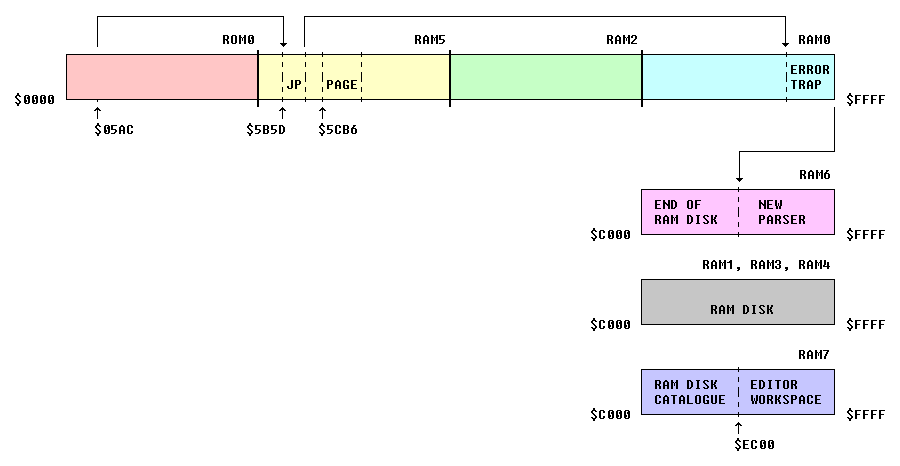

| Memory Map |
The extended BASIC parser resides within four areas of RAM:
- A modification of the 128 system variable RAMRST, replacing the RST 08H instruction with a JP instruction.
- An error trap block at the end of conventional RAM that intercepts any of the possible JP destinations from RAMRST.
- For error "C Nonsense in BASIC", control is passed to the extended BASIC parser which resides in RAM bank 6.
- Paging routines inserted where the channel information normally resides are used to coordinate the switching between the two ROMs and the RAM banks when executing commands.
