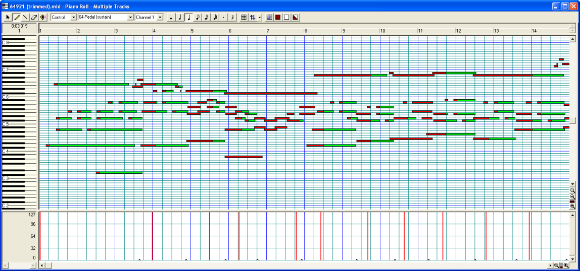

Here Cakewalk is displaying a comparison of the before and after MIDI files for an Ampico piano roll with its infamous note extensions. The new note timings are superimposed in red over their original lengths shown in green. The sustain pedal timings shown underneath remain unchanged.

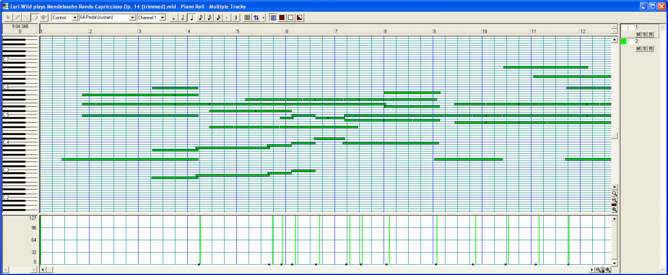

Here is an even more extreme example produced by Artificial Intelligence software that converts audio files into MIDI. While sustain is on there is only a miniscule gap between notes, and while this might not pose a problem for synthesised pianos, it is physically impossible for solenoid pianos to react that quickly.

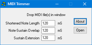

Operation
MIDI files may be either type 0 or type 1 and will normally just contain a single piano track.
Drop the MIDI file into the program window and the output file will be stored in the same folder with a modified filename ending in (trimmed).mid
There are three parameters to play with, although the default settings are a good starting point.
Shortened Note Length Notes for which the sustain is on for their entire duration are shortened to this value (unless they were already shorter than this).
Note-Sustain Overlap Where sustain is only actuated while a note is already playing but then remains on for the remainder of its duration, the note may be released early once the sustain has become established. This brief delay ensures that all the dampers have had time to clear the strings.
Sustain Extension Although any note that remains on after sustain has been released should not normally be trimmed, if it is only for this brief period then it is deemed to end at the same time as sustain is released and so becomes eligible for trimming.
