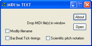

MidiToText decompiles MIDI files into an editable ASCII text format. TextToMidi recompiles the text files back into MIDI files. The syntax follows the standard set by DOS utilities MF2T and T2MF.

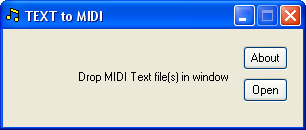

Drop the MIDI file into the MidiToText window to produce a text file of the same name (apart from the .txt extension). Alternatively, use the Modify filename option to create a text file of the form * (M2T).txt, to ensure that the recompiled MIDI file does not overwrite the original. To recompile, drop the MIDI Text file into the TextToMidi window.
