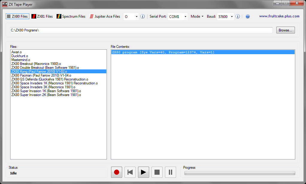

The ZX Tape Player utility (for Windows) is used to load and save ZX80 programs via a PC's serial port at 57600 baud (19200 is only applicable for legacy versions of the RS232 ROM up to V2.03).
To load a program from a PC using RS232, select ZX80 Files on the toolbar and choose the desired serial port. Click the Browse button and select the folder containing the ZX80 programs. The Files pane on the left hand side will be updated with all .O files. Clicking on a program in the list will cause a summary of the file's contents to be displayed in the File Contents pane. On the ZX80 emulator, type LOAD and click the PLAY button on the ZX Tape Player utility.
To save a program to a PC using RS232, click on the RECORD button and specify a location and name of the file to save the program in. On the ZX80 emulator, type SAVE and the program will be transferred to the PC. The PC file is automatically closed once the file has been received.
