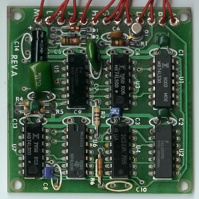

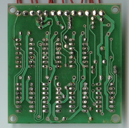

The SLOW mode upgrade was a small double-sided circuit board that had to be soldered to the ZX80 PCB via several flying leads. In addition, several tracks of the ZX80 PCB had to be cut.
| SLOW Mode Board - Top | SLOW Mode Board - Bottom |

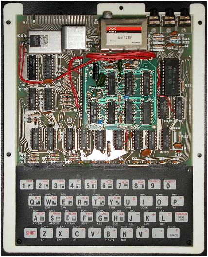

If fitted very close to the ZX80 circuitry then it was possible for it to fit underneath the top of the ZX80 case.
| SLOW Mode Board Fiited to a ZX80 |

The SLOW mode board works by generating horizontal synchronisation (HSync) pulses during the top and bottom border areas, letting the original ZX80 hardware generate the HSync pulses for the picture area. As with the ZX81, non-maskable interrupts (NMI) are used to count down the number of border lines to output before running the display driver routine in the ROM to generate the picture area or vertical synchronisation (VSync) pulse. It uses a counter that counts 207 clock pulses before resetting back to 0. At a count of 0, a HSync pulse is begun and it will end when the count reaches 20. An NMI generator circuit is switched on during the top and bottom border durations and this circuitry passes the HSync pulses to the ZX80's video output. When the picture area is being output, the NMI generator is switched off and now the HSync pulses produced by the ZX80 hardware are allowed to pass to the ZX80's video output. The 3 bit character line counter is held in reset whenever the NMI generator is switched on and released when it is switched off. With the NMI generator off, the character line counter will again be held in reset when a read occurs from input port $FE to start the VSync pulse. The character line counter is released when the VSync pulse ends via a write to any other output port (typically $FF).
The assembly instructions refer to the SLOW mode board suffering from a couple of 'funnys':
- The top row of the picture is slanted to the right.
- Adjustment of a resistor value may be required if all characters appear rotated vertically.
The slanting of the top row occurs due to misalignment of the HSync pulses produced by the SLOW mode board compared to those from the ZX80. The ZX80 and SLOW mode board produce HSync pulses that are 20 and 19.5 clock cycles wide respectively, both starting on the rising edge of the clock. On the ZX81 the HSyncs are only 16 clock cycles wide. The first line after the SLOW mode board stops generating the HSyncs, the responsibilty passes to the ZX80 and it ouptuts HSyncs that occur 1 clock cycle later than those from the SLOW mode board. They therefore end 1 clock cycle later as well. In addition, the shorter duration of the SLOW mode board's HSync means that there is a misalignment of 1.5 clock cycles as seen by the TV. Subsequent HSyncs output by the ZX80 align since they are generated at a regular 207 clock cycle interval. When responsibility switches back to the SLOW mode board to generate the HSyncs for the bottom border, the first HSync it outputs occurs 1.5 clock cycles sooner than those from the ZX80. Subsequent HSyncs again occur at a regular 207 clock cycle interval and so are aligned. Therefore, the duration between two consecutive HSyncs is 208 clock cycles for the last line of the top border and 206 clock cycles for the first line of the bottom border. The slanting occurs as the TV adjusts to the new position of the HSyncs in the picture area. It will also adjust again as the bottom border is begun, but this is not noticeable since slanted white just appears like any other white.
The issue characters being rotated vertically within their cells can occur due to the way the SLOW mode board circuitry drives the character line reset line using discrete diodes and resistors rather than an IC. However, once a suitable resistor value has been found to work for a particular computer then it will remain working reliably.
