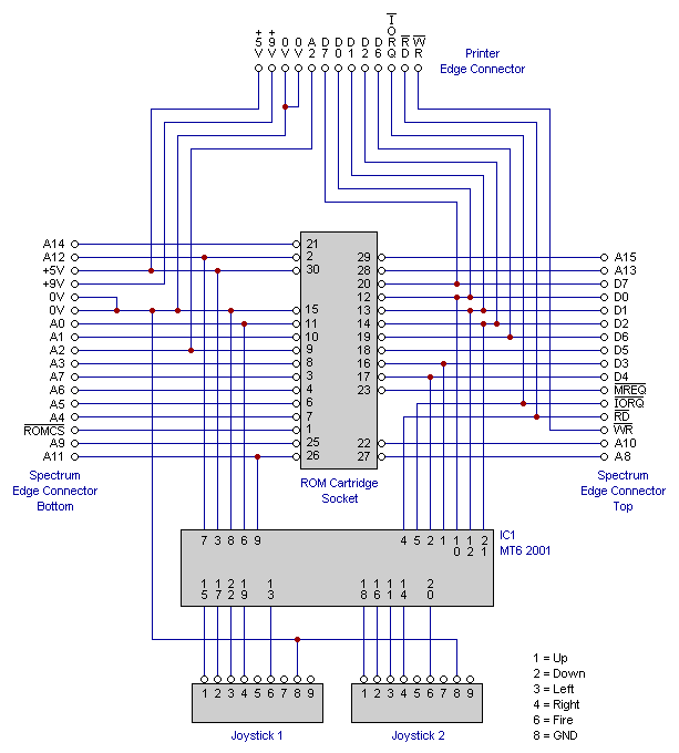

The circuitry of the ZX Interface 2 is very simple and is comprised of a single custom made IC which performs address decoding for the twin joystick interface. The ROM cartridge socket simply exposes signals already available from the Spectrum's edge connector.

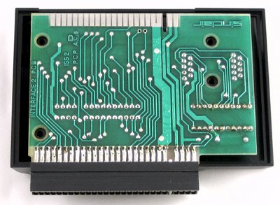

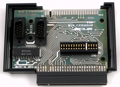

As can be seen from the P.C.B. photographs, at least two issues of the board were produced. However, the Service Manual indicates that no modifications were made to the ZX Interface 2 design and hence it is likely that only issue 2 versions were sold.
The circuit diagram of the ZX Interface 2 is shown below:

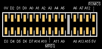

The pinout of the ROM cartridge slot is shown below. Note that the contacts of the socket, and of each ROM cartridge, are gold plated to achieve a more reliable electrical connection.
TOP VIEW |
When a ROM cartridge is plugged in, it connects the /ROMCS (ROM Chip Select) line directly to the 5V line. This disables the Spectrum's ROM thereby allowing the cartridge's ROM to appear in the 0 - 16384 memory map area. The cartridge's ROM must only output to the data bus when the lower 16K of memory is addressed. When an access to this memory area occurs, the address lines A14 and A15 and the /MREQ (Memory REQuest) line will all be at logic 0. These three lines are therefore used inside the cartridge to enable its ROM. Address lines A0 - A13 specify a location within the ROM and the data from that location is output on lines D0 - D7. Note that the /RD (ReaD) and /WR (WRite) signals exposed at the edge connector of the Spectrum are not available at the ROM cartridge slot. As a result, both read and write accesses to the ROM will be treated as a memory read. This is not a problem as, by its very nature, a ROM is a read-only device and hence would not be written to. This approach has the advantage that it reduces the size of the ROM cartridge socket but the main reason why it was adopted was to simplify the decoding circuitry required. It does however mean that a cartridge consisting of 8K ROM and 8K RAM is impossible as there is no mechanism for writing to the RAM. Also since the /RD and /WR signals are ignored, the ROM can also be accessed during the memory refresh cycle when the /RFSH signal is low.

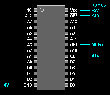

A ROM cartridge consists a small double sided P.C.B. with a 16K ROM chip mounted on it. The ROM is not housed in a standard DIL pin package but instead just the bare silicon is used. This reduces the size and fabrication cost of the ROM cartridge. The diagram below shows the 16K ROM as it might appear if housed in a DIL pin package, and aids in understanding how address decoding is achieved within the cartridge.
Although not shown in the diagram, address lines A0 - A13 and data lines D0 - D7 at the ROM cartridge socket connect to the corresponding pins on the ROM. A14 connects to the ROM's /CE (Chip Enable) pin. This pin must be held at logic 0 for the ROM to become selected. However, it is only when the ROM's /OE1 (Output Enable 1) and /OE2 (Output Enable 2) pins are both at logic 0 that data is output from the ROM. These two lines are driven by /MREQ and A15 respectively. Therefore only when a memory access is made with the upper two address lines held low will the ROM output data. This condition will only occur when reading (or writing) to addresses 0 - 16383, i.e. the lower 16K of the memory map. Note how the pinout of the ROM cartridge socket closely matches the pinout of a typical 16K ROM IC.

The two joysticks sockets are referred to as Joystick 1 and Joystick 2, with the socket for Joystick 1 identified by a dimple below it. The address decoding of the sockets is performed by IC1, which is labelled as 'MT62001 MCE 8344'. Joystick 1 mirrors the keyboard keys 6 to 0 and Joystick 2 mirrors keys 1 to 5. This approach allowed joysticks to operate with a wide range of existing games software since many supported a redefinable keys option. Joystick sockets 1 and 2 are read on I/O ports EFFEh and F7FEh respectively, as summarised below. The joystick input bits read back as '0' when activated.
