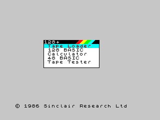

At power up, the Spectrum will present the standard Spectrum 128 menu consisting of Tape Loader, 128 BASIC, Calculator, 48 BASIC and Tape Tester. The bug free version can be distinguished by the title bar text displaying as 128+.

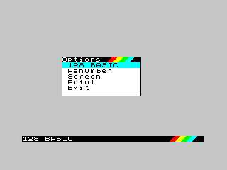

The 128 BASIC keywords SPECTRUM and PLAY are supported by the emulator, as are the renumber, print and screen toggle facilities.

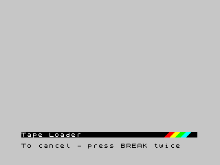

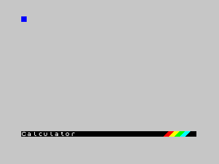

The Tape Loader, Calculator and Tape Tester modes operate identically to those found on a real Spectrum 128. However, the Tape Loader option assumes 128 BASIC mode and so when used on a 48K Spectrum the differences in use of the last 16K RAM bank may cause some 48K programs to fail. If such issues are encountered, then simply load the program from 48 BASIC mode instead. Any program that attempts to utilise the additional RAM found on the Spectrum 128 will obviously fail when the cartridge is used on a 48K Spectrum.

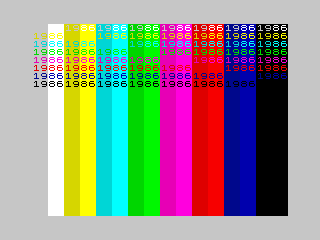

The test screen accessed on the Spectrum 128 by holding the BREAK key during power up is also reproduced in the emulator.
