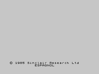

The Spanish 128 was released in 1985, a year before the Spectrum 128 was launched in the UK. The hardware of the Spanish model is essentially identical to the UK model but the Editor ROM code is nearly 40% different. There are no menus as on the Spectrum 128, but instead the machine starts up directly in 128 BASIC mode.

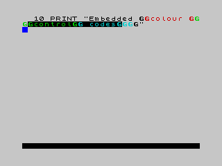

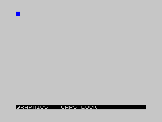

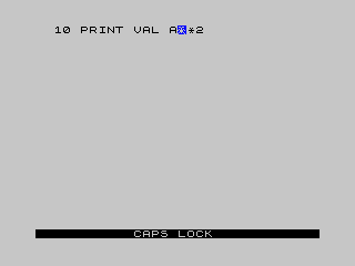

Like the Spectrum 128, the Spanish 128 when in 128 BASIC mode also requires commands to be typed in letter by letter, and the full screen editor behaviour between the models is very similar. However, all keywords must be entered in uppercase, which has the advantage that variables whose names are identical to keywords can be entered by typing them in lowercase. In the Spectrum 128, variables named the same as keywords are not allowed. The black banner at the bottom of the screen is used in the Spanish 128 to display mode information, i.e. whether Caps Lock is on or off, and whether the editor is currently in Graphics mode or Extended mode. Another advantage of the Spanish 128's editor is that it allows colour control codes to be embedded within programs, just as in 48 BASIC mode. The colour transitions are shown by two special 'G' characters showing the old colour and the new. The editor displays syntax errors differently to the Spectrum 128 by showing a bug symbol within the cursor instead of turning the cursor red.

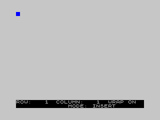

The EDIT command is used for two purposes. When followed by a line number, the cursor is displayed next to the specified line in the full screen edit area. When the command is followed by the name of a string variable, a text editing mode is entered that allows the contents of the string variable to be edited visually. If the variable already existed then the display is preloaded with the variable's contents. The cursor can then be moved around the screen and the contents of the variable changed as desired. The editor displays the current row and column position of the cursor and also the current mode, e.g. graphics mode or extended mode. The variable editing mode supports a number of options:
- Mode Entry - Insert, Overtype or Indent.
- Word Wrap - On or Off.
Insert mode will place the newly typed character at the current position, shifting all subsequent characters along by one. Overtype mode will simply replace the current character with the newly typed character. Selecting Indent mode will set the left hand margin that all newly created rows will use. The margin size is set as per the column that the cursor is at, capped to a maximum of column 26. The indentation column will revert back to column 0 when either Insert or Overtype mode is selected. The three modes are cycled between by pressing the keypad TOGGLE key (accessible via the keyboard by entering Graphics mode and pressing Z). When the Word Wrap option is set to On, it will prevent words from being split across rows by moving the whole word to the new row. Word Wrap can be switched on and off by pressing the keypad key combination of SHIFT and TOGGLE (accessible via the keyboard by entering Extended mode and pressing Q).
