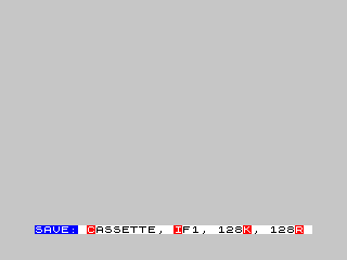

When a LOAD, VERIFY, MERGE or SAVE command is executed, the ROM cartridge must determine the channel type to use. It does this by examining the contents of the unused system variable at location 23728 ($5CB0) when loading, verifying or merging, and by examining the unused system variable location 23729 ($5CB1) when saving. These are will hold channel identifiers, with supported values being 'C' for cassette, 'I' for Interface 1 RS232, 'R' for Spectrum 128 RS232, and 'K' for Spectrum 128 KEYPAD. Any other value will cause the ROM cartridge to prompt the user for the channel type by displaying a simple menu on the bottom row of the screen (when first powered on, these system variable locations will hold values of $00 and so a menu will be displayed by default).
Spectrum RS232 Load Menu Screenshot Spectrum RS232 Save Menu Screenshot
Press the highlighted key to select the corresponding channel, or BREAK to exit the menu. When a load or save command is subsequently encountered, the same channel will automatically be used. To switch to another channel, locations 23728 and 23729 can be POKEd with the new channel identifiers or with $00 to cause the corresponding menu to be displayed next time a load or save operation occurs.

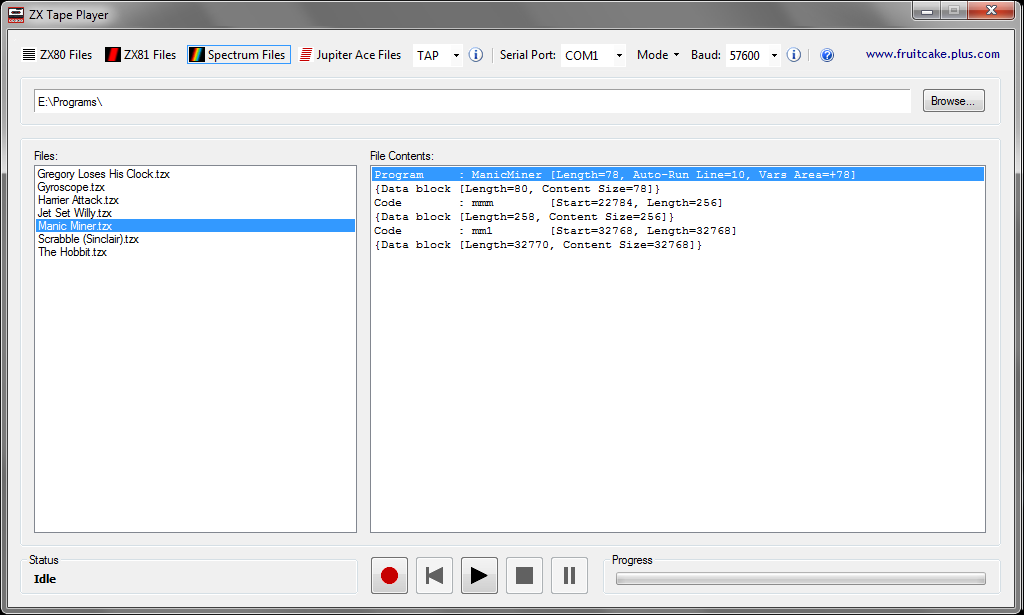

I have produced a Windows application to allow emulator TAP and TZX files to be loaded/saved via RS232 from/to a PC. A screenshot of the application is shown below:
ZX Tapre Player
To load a file into the RS232 ROM, ensure Spectrum mode is selected and then use the drop down list to select either TZX or TAP file format. Click the Browse button and select the folder containing the Spectrum files and the Files pane on the left hand side will be updated with all applicable files. Clicking on a file in this list will cause a contents breakdown of the file to be listed in the File Contents pane. Select the serial port from the drop down list and ensure the baud rate is set to 57600 (9600 is only applicable for legacy versions of the RS232 ROM up to V1.03, and 19200 is only applicable for legacy versions up to V2.00). On the Spectrum, type LOAD "" and the load menu will be displayed (unless a load channel has previously been selected). Choose the desired RS232 channel and then click the PLAY button on the ZX Tape Player utility. The blocks shown within the File Contents pane will be transferred through the serial connection in sequence. The STOP and PAUSE buttons can then be used. When stopped, the REWIND button is available and clicking it will cause the reselect the first block of the file. Alternatively, it is also possible to click on any of the blocks within the File Contents pane and then play from that point onwards.
The RS232 routines in the emulator cannot cope with a burst of data bytes from the PC but instead relies on the handshaking lines being checked by the PC between bytes. Not all serial ports do this, although most USB-to-RS232 adapters do. If loading problems are encountered, try checking the Single Byte Writes under the Mode drop down setting.
To save from the Spectrum to the PC, click on the RECORD button and specify a location and name of the file to create. On the Spectrum, type SAVE "name" and the standard "Start tape, then press any key" message will be displayed. Pressing a key will cause the save menu to be displayed (unless a save channel has previously been selected). Choose the desired RS232 channel and then the program will be transferred to the PC. The PC file remains open to receive further data from the PC, thereby allowing multi-part programs to be transferred. Once all parts have been saved, click the STOP button. When recording, the PAUSE button is available if required.
