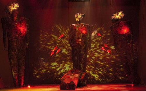

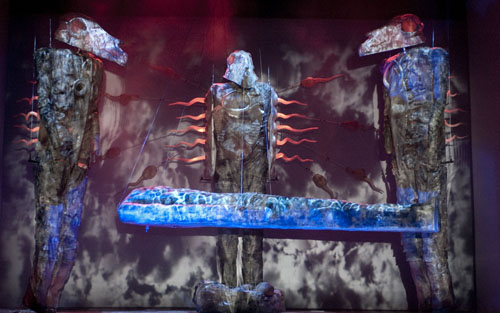

The set, designed by George Tsypin, is dominated by 4 monumental sculptures of giants, surrounded by 3 walls. Projections are used to bring the giants to life and integrate them into the stage action and dramaturgy of the Ring in this bold and controversial production of the work. T
wo Barco 18K projectors are positioned at FOH and fed by one Catalyst system, with 4 Barco DLM digital moving lights positioned on the proscenium bridge, driven by the other two. Running on 44 video layers in total they project special effects, texturing and movement, plus literal elements like fire, water, lightening etc. onto the floor, set and giants, all of which needed careful masking - which was easy to achieve using Catalyst.
