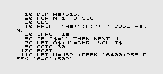

The 8K ROM version stores the machine code bytes in a string array. A loop is used to allow each byte to be entered. Once all bytes have been entered, the loop can be executed again using GOTO 20 and can now be used to verify each byte entered. Pressing NEWLINE will move to the next array entry without modifying the current entry. Once the entry of the machine code bytes has been verified, the complete program should be saved to cassette. The game is then be run by typing GOTO 100. This executes a short machine code transfer routine that copies the game bytes from the array to location $4000.

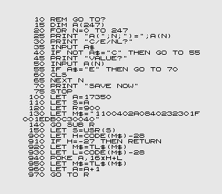

The 4K ROM does not support string arrays and so instead an integer array must be used. The 4K ROM only allows integer arrays of up to 256 entries in size, but this is sufficient to hold the game bytes. The 4K ROM also does not support the VAL function and so a different mechanism is used to allow review and modification of the bytes. The user is asked to input C to change the byte at the current location, or NEWLINE to skip to the next address, or E to exit the entry loop. Once the machine code bytes have been typed in the complete program should be saved to cassette. The game can then be run by typing GO TO 100. This pokes a shorty machine code transfer routine into RAM and then runs it to copy to contents of the game bytes held in the array to location $4000.
To modify the 4K ROM version to run on 60Hz models of the ZX80, enter the following before running the game: LET A(18)=14539.
To modify the 8K ROM version to run on 60Hz models of the ZX80, enter the following before running the game: LET A$(136)=56 and LET A$(145)=56.
