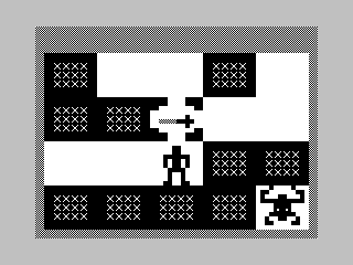

However, the game generates its display to the ZX81's display file memory, which the Spectrum knows nothing about. Therefore, although the game would run happily once relocated, only a blank screen would be displayed by the Spectrum. The solution to this was to patch the machine code so that after the ZX81 display file memory has been updated, a new routine is executed that renders the image that the ZX81 would be displaying into the Spectrum's display file. Fortunately there were only 4 places within the code that needed to be patched.

Even with these patches in place, the Spectrum conversion ran significantly faster than the ZX81 original and so a delay was introduced after rendering of the ZX81 display into the Spectrum's display file. This delay was adjusted to achieve a game speed approximating that of the ZX81 original.
