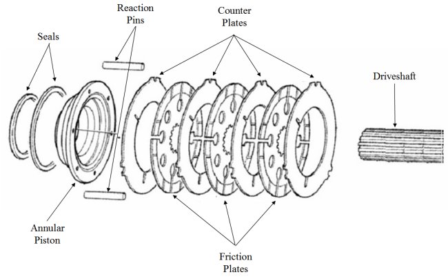

The braking faces are between a number of interleaved friction discs and counter
plates alternately keyed to the housing or splined to a driveshaft. The plates
are clamped together to produce a braking torque either by an annular piston
which is coaxial with the driveshaft or by a ball and ramp mechanism.

Annular Piston Brakes
Annular piston brakes have the benefit of simplicity of construction.
As the piston only moves in an axial direction to load the brake plates there
is no inbuilt servo effect and the brake factor is one. A low brake factor means
that the brake torque between left and right brakes will be more equal (since
differences are not amplified) and the brake system will be more controllable,
for a similar actuation.
On the downside, to get a given torque output a bigger piston will be required
and this together with the long rubber seals (one metre or more) consumes a
greater fluid volume. In order to minimise pedal travel, in none power brake
applications, annular piston brakes run with low clearances and often have a
method of controlling the amount of piston retraction.

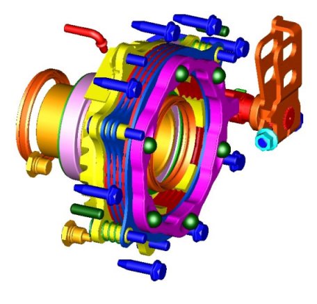

Ball Ramp Brakes
Ball ramp brakes have a mechanism inside the axle however if they are hydraulically applied the actuation is usually accessible from outside which helps to reduce servicing costs. In order to make a ball ramp actuator non servo the actuator must be decoupled from the friction plates. This is best done by using a needle roller bearing but Yamaha use a low friction plain bearing on this ATV brake as an acceptable trade off between performance and simplicity.

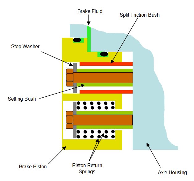

Annular piston brakes often use a controlled back-off mechanism to ensure the
running clearance is maintained as plate wear takes place. This usually consists
of a spring and a friction device.
This is a part section of a Caterpillar annular piston brake showing
one of the, usually three retraction devices.
When the brake is applied brake fluid pressurises the annular area between the two seals and forces the brake
piston to the left, clamping the friction plates to the counter plates
(not shown). If no adjustment is required then the split
friction bush pressed into the brake
piston does not contact the stop washer.
Releasing the brake pressure allows the piston
return springs to reset the brake piston until the end of the split friction bush touches the axle housing.
Should adjustment be required the split friction
bush touches the stop washer before sufficient clamp load is generated on the friction plates, this causes
the split friction bush to be dragged
down its bore. When the brake is released the brake
piston is reset to a new back stop position.
This type of adjuster is not load insensitive and could over-adjust if a high
pressure stop allowed the piston to move beyond its normal position however
given the brake is a full circle and the friction material is very thin the
brake is so stiff as to not require a more complex adjuster.

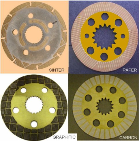

Friction Material Type
There are four basic types of friction material available each with there own pro’s and cons, sintered, paper, graphitic, carbon.
Sintered bronze is made by sintering a blend of powders into a
porous matrix on a steel carrier plate. It is a tough durable material well
able to live with overheating. On the downside it has a low dynamic friction
and a high static / dynamic friction ratio which can cause chatter noise.
Paper frictions materials are so called because of the manufacturing process
as much as the material itself. They contain a range of fibres and friction
modifiers which are then saturated in resins. The resulting material is soft
and easily damaged. Paper materials have a high dynamic friction level and a
low static / dynamic friction ratio which gives them good torque capacity and
low noise however their energy capacity tends to be low.
Graphitic materials are moulded compositions of graphite and resin binders.
The have good thermal capacities which make them durable however they have a
moderate static / dynamic friction ratio which may make them noisy.
Carbon linings give stable friction, high load and low wear but are very expensive
as such they are rarely used.
