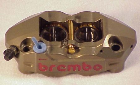

What’s the benefit of the latest radial mount calipers fitted to motorcycles?
Maybe there are some real advantages but we suspect it’s not really performance.
Multi Piston Calipers
Calipers may have more than one piston on each side of the disc,
the main benefit of a multi piston brake is increased effective diameter, since
two smaller diameter pistons allow a narrower pad to be used, which for a given
disc means the torque radius is increased.
Multi piston brakes may reduce the instances of longitudinal taper wear of the
pad since the pad is supported over more of its length. Some manufacturers offset
the pistons or use a slightly larger bore at the trailing end of the pad to
positively bias the pad wear, however this will make the brakes handed L/R.
On the downside a narrower pad has a smaller swept width and cannot transfer
heat into the disc as effectively.
