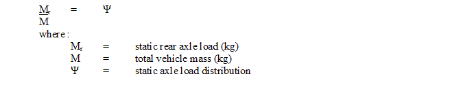

Static Axle Load Distribution

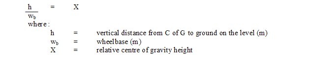

Relative Centre of Gravity Height

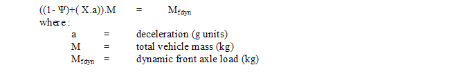

Dynamic Axle Loads (Two Axle Vehicles Only)
The changes in axle loads during braking bears no relationship to which axles are braked. They only depend on the static laden conditions and the deceleration.
Note: The front axle load cannot be greater than the total vehicle mass. The rear axle load is the difference between the vehicle mass and the front axle load and cannot be negative. It can lift off the ground though. (Motorcyclists beware)!

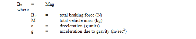

The total braking force required can simply be calculated using Newton’s Second Law.

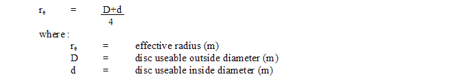

The effective radius (torque radius) of a brake disc is the centre
of the brake pads by area.
For dry discs it is assumed to be:
For full circle brakes it is:
Note: the difference is because full circle brakes contact on the full face but caliper pads are not usually a quadrant but have square sides (Given the variability of friction the difference is not important in practice).

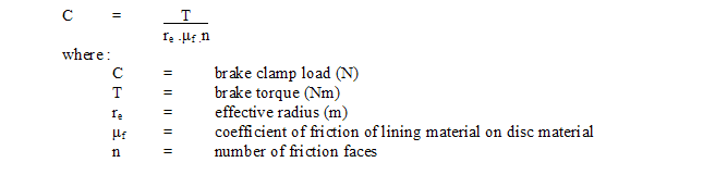

The clamping load is assumed to act on all friction surfaces equally. For dry disc brakes it doesn’t matter whether the brake is of the sliding type or opposed piston. Newton’s Third Law state every force has an equal and opposite reaction and a reaction force from a sliding caliper is the same as an opposed piston one.

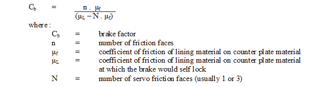

BACK TO TOPBall ramp brakes have a self servoing effect rather like a drum brake. The brake factor multiplies the output torque.
High factor brakes become very sensitive to manufacturing tolerances and lining friction variations. A measure of sensitivity is the amount the brake factor varies for a change in lining friction. It can be calculated:

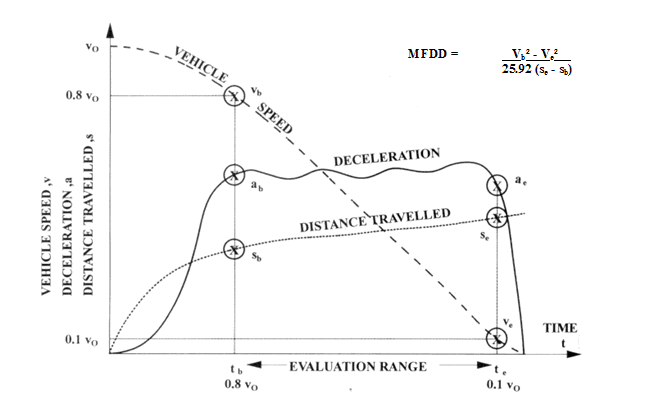

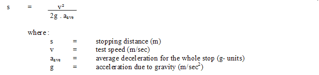

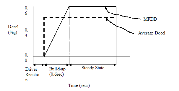

The deceleration used in calculations is a steady state one called MFDD (mean fully developed deceleration). It assumes the vehicle is either braking or not. In practice it takes a time for the system pressure to rise and the friction to build up. This is not the driver reaction time but the system reaction time. Where a calculation requires a stopping distance or an average stop deceleration then this delay must be taken into account. For calculations a linear build up over 0.6 second is used ie 0.3 second delay.
For testing the following graph show the requirements for 71/320/EEC and ECE R13.

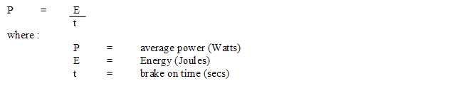

In order to calculate the power we need to know the brake on time:
The power is then given by:
This is the average power, the peak power at the onset of braking is double this.

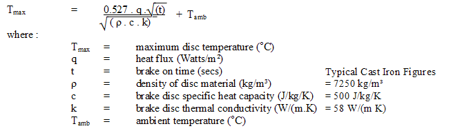

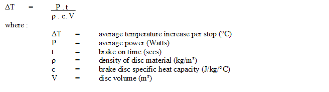

In order to approximate the temperature rise of the disc an assumption as to where the energy is going has to be made. Initially most of the heating takes place in the disc, however this can then be rapidly cooled by surrounding components and the air stream. The calculation assumes 80% goes to the disc.
Heat flux into one side of the disc:
Single stop temperature rise is:
The temperature rise after repeated stopping can also be approximated, although so many variables exist it is suggested this is only used for basic optimisation work.
After a number of stops:

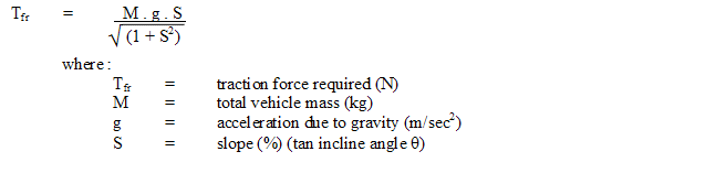

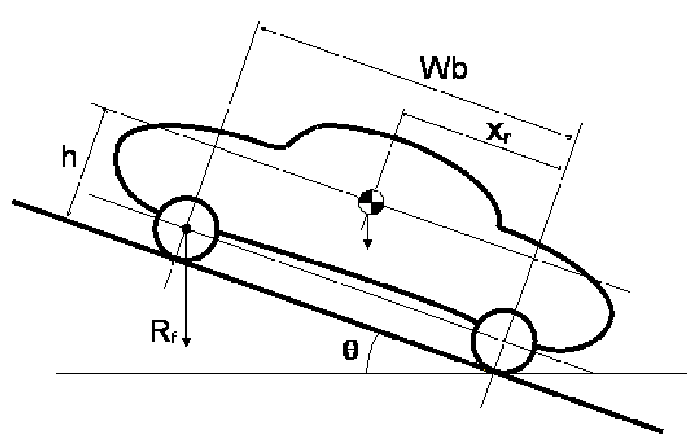

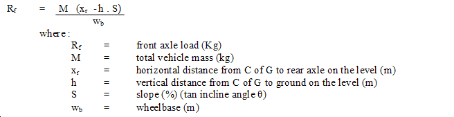

When parking on an incline the lower axle has a higher load than it does on the level.
The rear axle load is the difference between the vehicle mass and the front axle load.
If the braked wheel is very light on an incline then it is possible the tyre will slip before the brake. Hill hold is usually required with the vehicle facing both up and down the hill. The traction force required to park the vehicle is:
Where only one of the two axles is braked the limiting slope is:

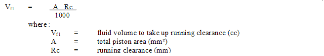

Brake Fluid Volume Requirements
When an hydraulic brake is applied fluid is required to move through the pipes.
If the fluid source is a master cylinder it has a finite capacity. The following
components need fluid:-
Brake fluid is required to take up running clearance.

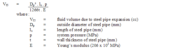

Pipe expansion is very small and unlikely to be of interest however it should
be noted that it is proportional to the cube of the diameter, so using bigger
pipe than necessary on a system with a fixed fluid volume will cause longer
travel for two reasons, the stiffness of the pipe and more importantly the additional
fluid compression losses.

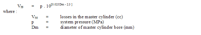

Fluid losses in master cylinders increase with bore size and pressure. A reasonable
assumption can be found by using the following:

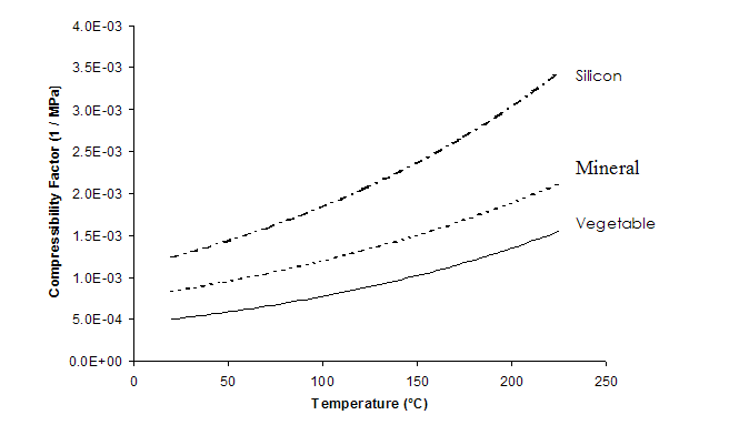

Fluid compression varies with temperature and the type of fluid used.
The fluid needed to take account of compression is calculated:
